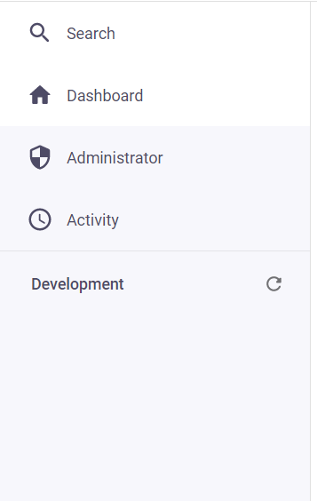

When starting the app I get the ModuleNotFoundError. Furthermore, when I go to my development workspace, I cannot see the entities on the left side (which is weird, because I always saw that, even if the app wasn’t started yet):
Reloading doesn’t work either.
Hope someone can help me.
