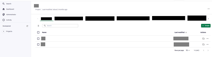

Instead of the current scrolling mechanism:
Users would be presented with a dropdown listing all available child entities, allowing them to select a table from that list. Thus, this would make show_children_as = 'Table' a much more attractive option for large sets of EntityType (think 10+ or 20+ EntityTypes, and lists with 20+ to 100+ entities).

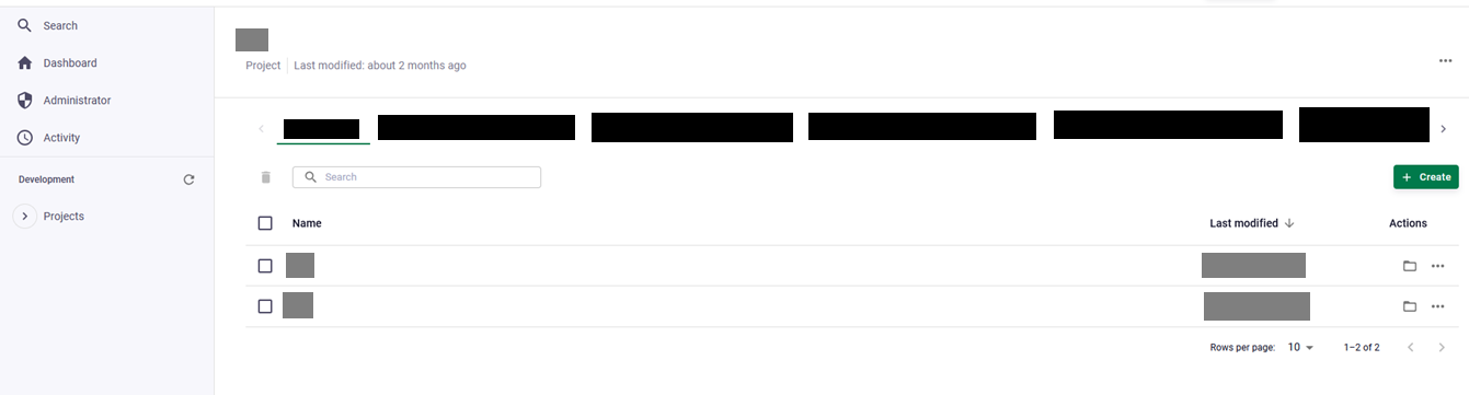

@StijnJ is there a way to set this value to something else than 10 (e.g. 25, 50, 100)?
I think this is perhaps one of the feedback I hear the most from our users. This particular example is a table made with a ChildEntityManager, but this also applies to the website in general.
I believe this covers the subject well Default rows per page
