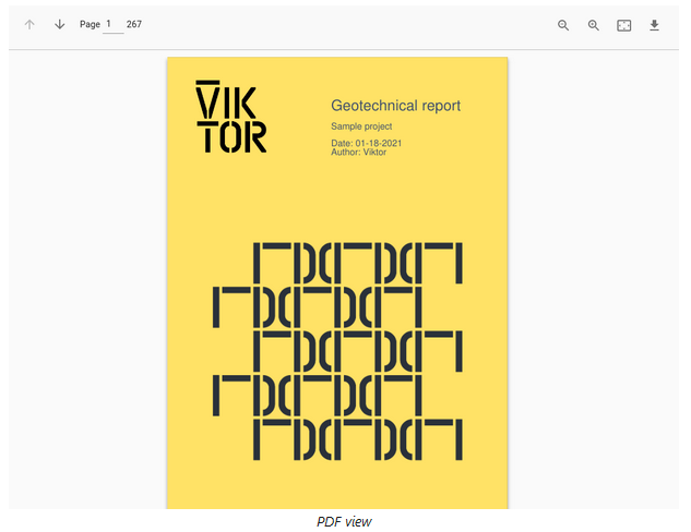

An example from the PDF View:
  • Currently, there is no direct method to print WebView content within VIKTOR, which limits our ability to export high-fidelity PDF documents from the platform. (This was throughly tested on our end last year)
