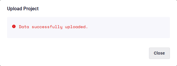

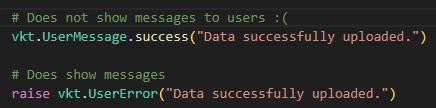

I am also running into messages not showing up to the user, and would love a solution here. I am currently using userErrors to display success messages, which is not ideal!
Maybe there is some nuance I’m missing here, but my expectation would have been a popup or UI indication for the success.
