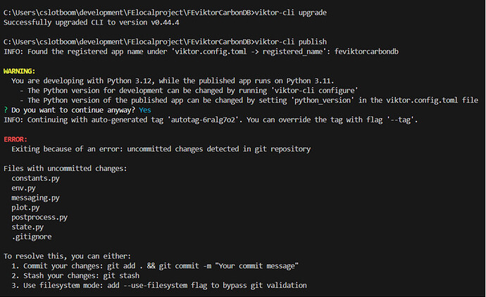

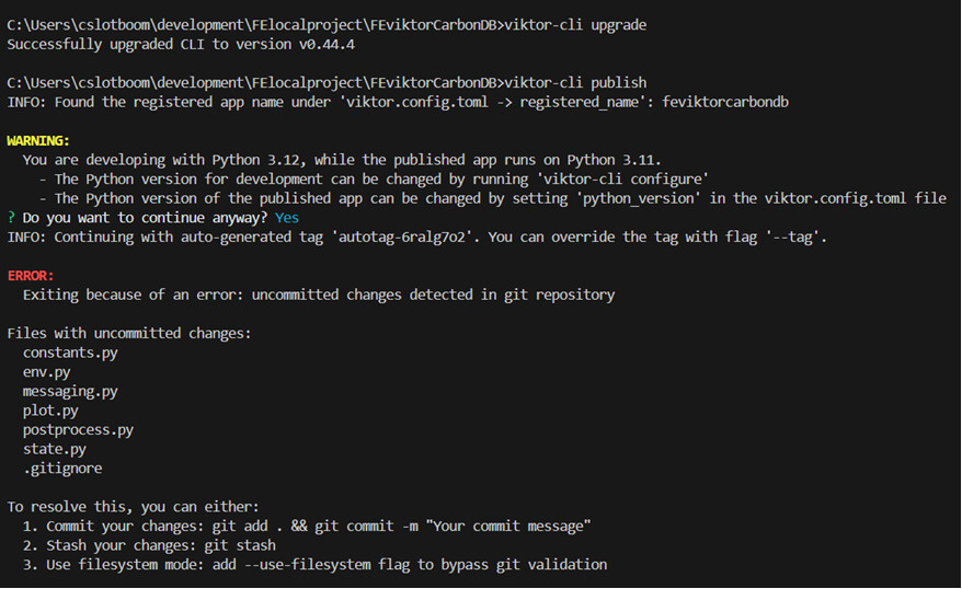

Viktor is picking up uncommitted git changes, where there aren’t any. I’m wondering if anyone else has encountered this or has a work around.
@bvanderhulst @mozturk FYI, might be the latest CLI addition?
I suspect that the files are untracked. If you run git status you would see them in the list of “Untracked files”, is that correct? In that case, you can run git add . to add them first, as shown in the CLI message.

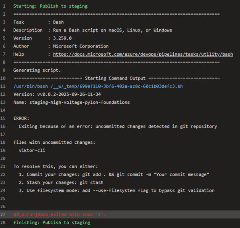

We have the same problem in our pipelines apparently

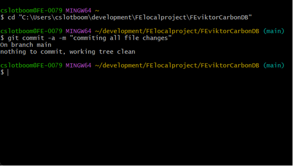

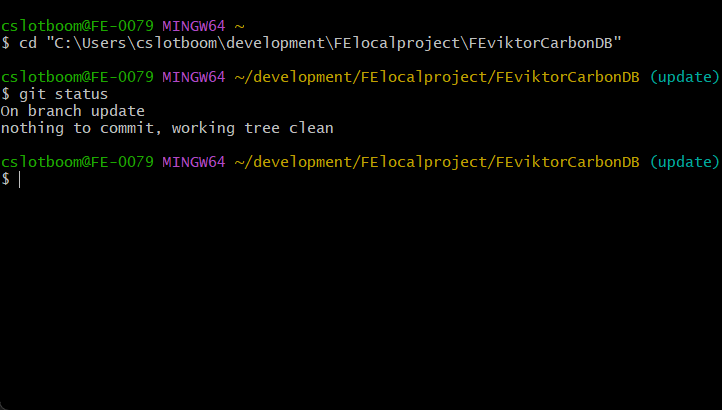

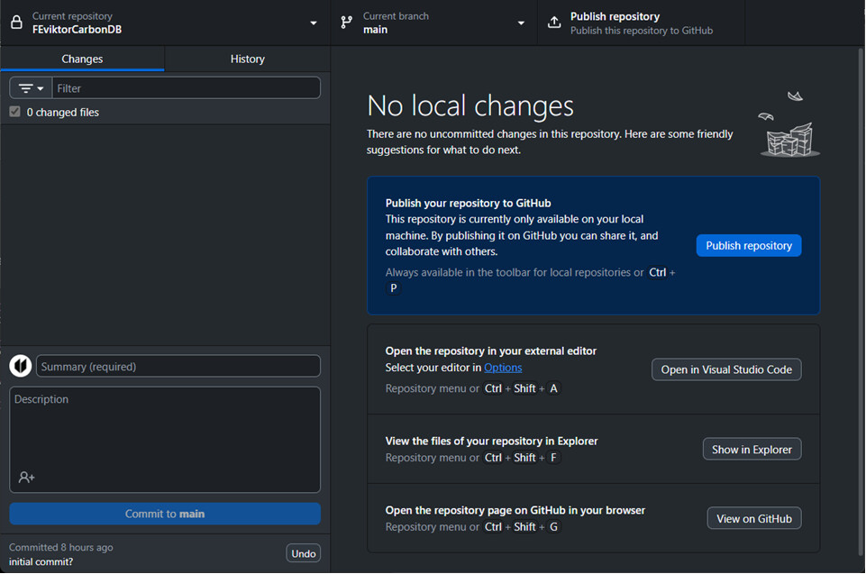

Thanks for your response, no such luck sadly.
I’ve been doing everything pretty much the same as I always have so surprised to see this crop up, though I will note I did do an update to my viktorCLI recently.
