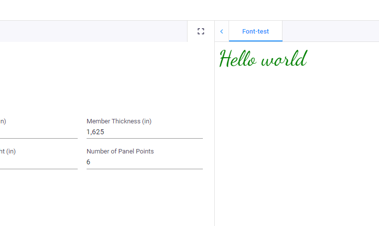

Hi again,
I’ve been in contact with our front-end team about this and they’ve managed to get it to work by simply importing the font from a url. A snippet of what that would look like in html code:
<!DOCTYPE html>
<html>
  <head>
    <title>Google fonts import</title>
    <meta charset="UTF-8" />
    <style>
      @import url("https://fonts.googleapis.com/css2?family=Dancing+Script&display=swap");
      .fancy-text {
        font-size: 48px;
        font-family: "Dancing Script", cursive;
        color: green;
    </style>
  </head>
  <body>
    <div class="fancy-text">Hello world</div>
  </body>
</html>
Would that be a possible solution for you?
In my test this shows up very fancy :wink:
