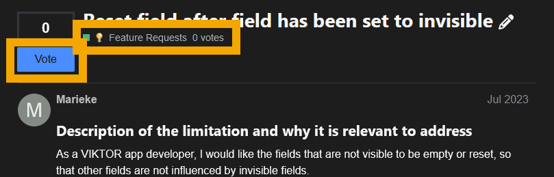

Thanks for your reply Marcel. How do I upvote or change this thread to a feature request?
Hi @thomasvdl ,
This thread is already a feature request, as it has been posted on the Feature Request board. To upvote, simply click on the button next to the heading:
