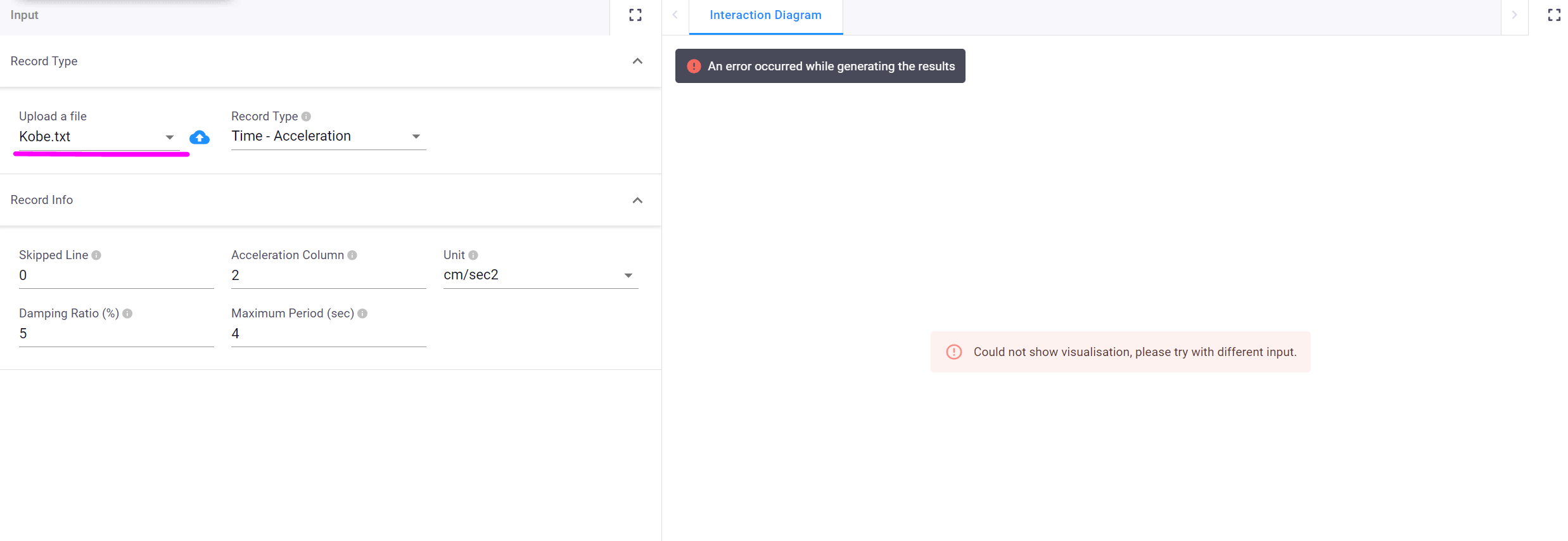

Thanks for the answer. Actually I tried whatever I found in the documentation. Now, I tried your solution but I got an error about the readlines() command.
Here is my code block:
    elif params.page_2.data_type.record == "Time - Acceleration":
        file_resource = params.page_2.data_type.file  # obtain the file resource from the field
        file = file_resource.file  # get the file (of type `File`) from the file resource
        with file.open() as f:  # open the `File` as usual
            lines = f.readlines()
            lines = lines[params.page_2.data_conf.skipped_line:]
            data = []
            for line in lines:
                values = line.split()
                if params.page_2.data_conf.acc == 2:
                    data.append([float(values[0]), float(values[1])])
                else:
                    data.append([float(values[1]), float(values[0])])
            df = pd.DataFrame(data, columns=["t", "acc0"])
            dt = df["t"][1] - df["t"][0]
I just uploaded the .txt file but still cannot read it. Am I missing something I did not get it tbh.
