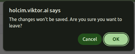

Hi Stijn,
This functionality is working.
However, there is still a pop-up that could be confusing for the user:
Hope this can be removed.
Best,
Fulei
Hi Fulei,
That shouldn’t be the case indeed, thanks for the feedback. We will pick this up.
Stijn
