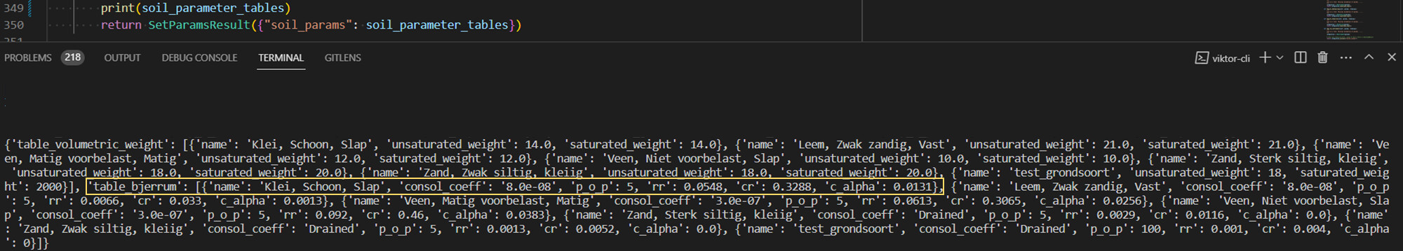

Parametrization:
Print statement of table before return SetParamsResult (the 4 decimals are visible in the yellow box):

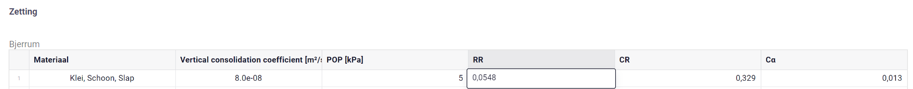

NumberField in table in UI:
When I open a field I can see that there are in fact 4 decimals in the field but only 3 are shown.
I expect the number of decimals to be displayed as set in the parametrization
