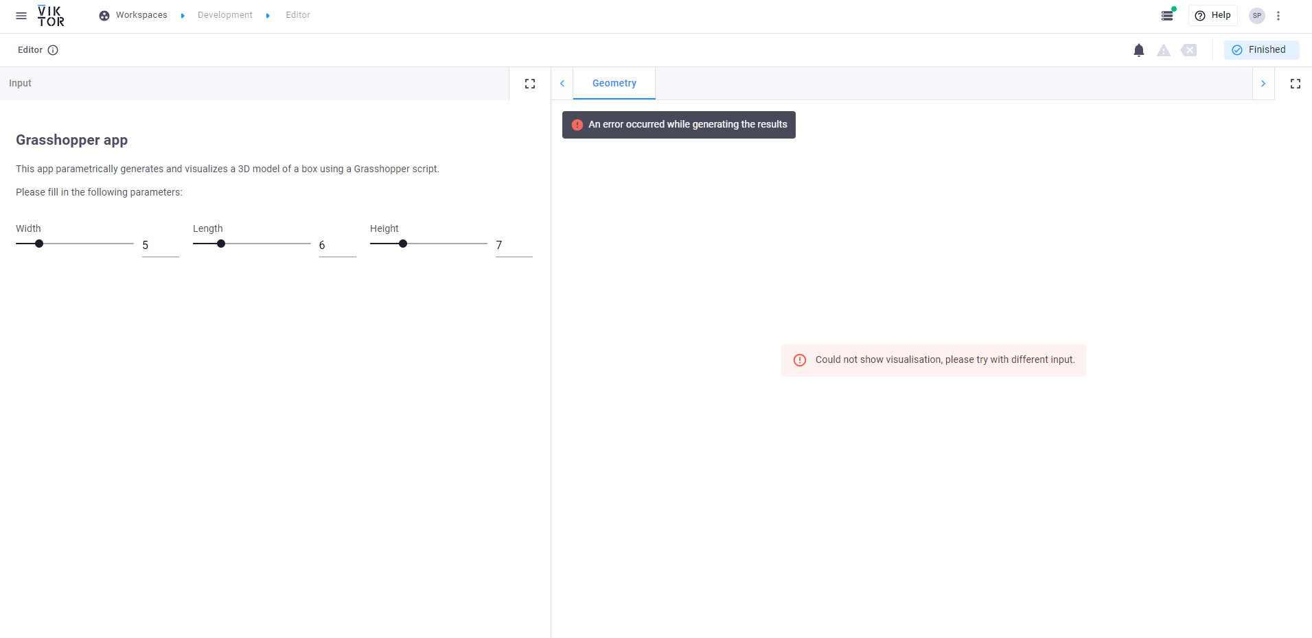

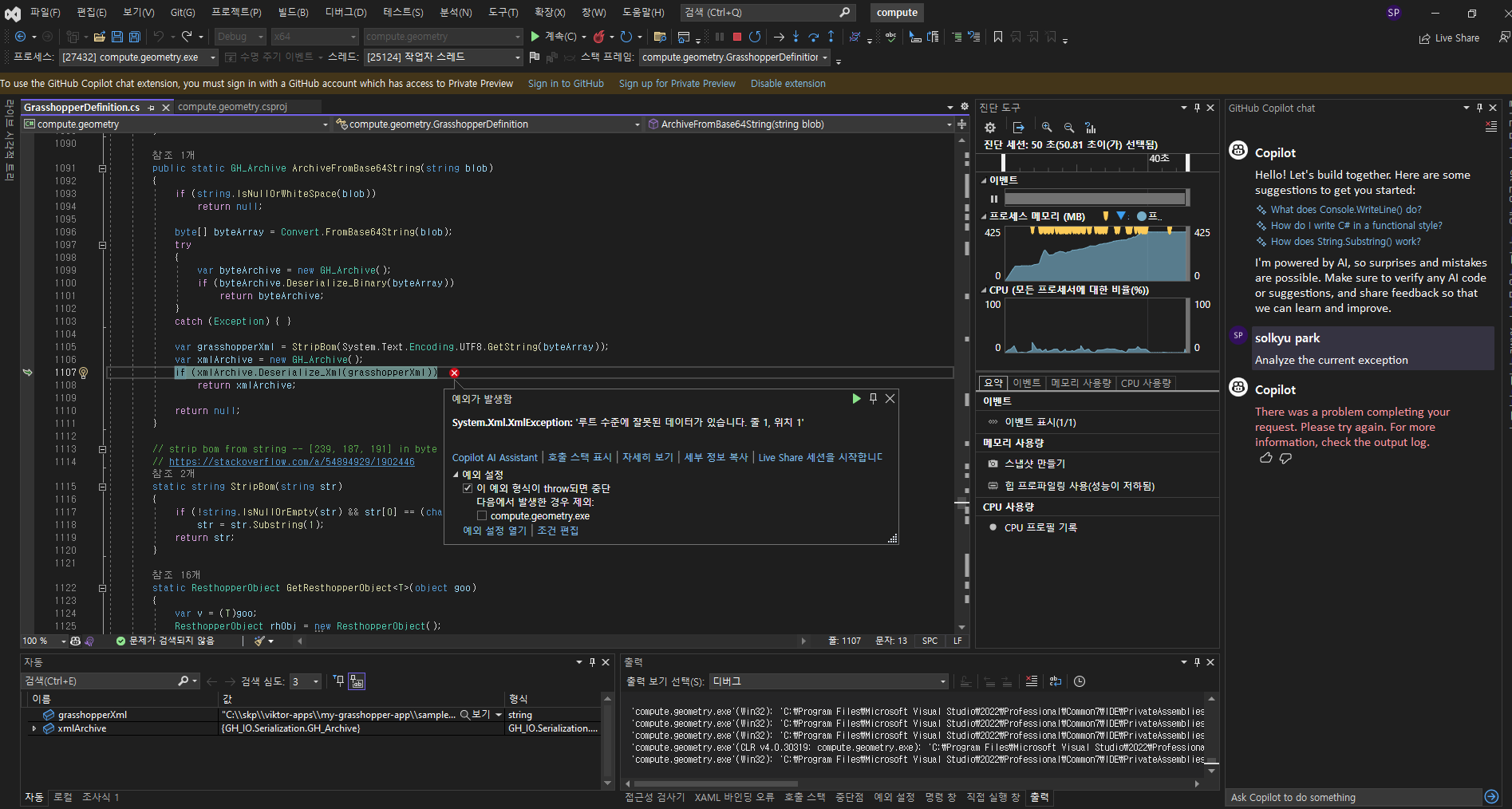

Despite configuration, including verifying the URL and API_KEY, I am not seeing the expected results on my screen. The only error message I receive from Rhino Compute is related to ‘wrong data on root level’, but the specifics of this error are unclear to me.

Hi! Thank you for your prompt reply. It is the second method that i find it not working at the moment. Alrhough it seems like i have managed to follow along and there isbno clear error message, yet the app does not visualize grasshopper on viktor…
The Python code for the second method is slightly different from the first. Did you make sure to follow the Python example in the documentation of the second method?
From your screenshots it looks like the request is never received by the Rhino Compute server. Are you running the Rhino Compute instance on your local machine? If this is the case, maybe you could try to first access the Rhino Compute server from a local Python script, before accessing it from your VIKTOR app in order to make sure that the connection is successful. Also, in this case keep in mind that if you publish your app, the app code cannot access the local Rhino Compute server. For production purposes you should setup a remote server (or go with method 1).
You were absolutely right… Regarding the connection issue,
It appears that my requests weren’t reaching the Rhino Compute server.
I’ve realized that a license for Rhino Compute is required. I’m currently in the process of obtaining this license from our company. As soon as I have it, I’ll be able to proceed with the next steps and hopefully resolve the issue.
