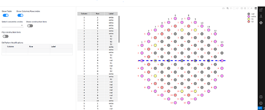

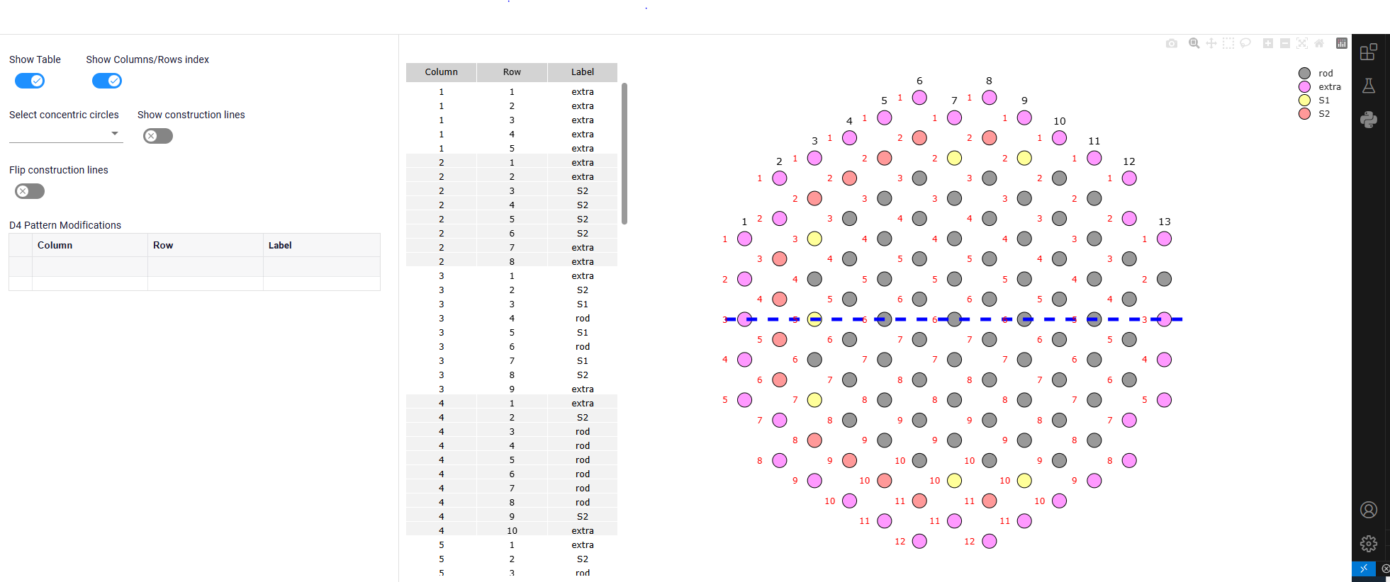

I’m building a VIKTOR app that visualizes a circular pattern of rods using (column, row) coordinates. Each rod has a label (e.g., rod, extra, S1, S2), which is automatically assigned based on internal rules. However, sometimes these labels need manual adjustments.
Currently, I show the pattern with:
  • An plot on the right (see screenshot below)
  • A plotly table on the right to see all the rods and their label
  • A parametrization table on the left where users can change labels rod by rod
This works fine for small patterns, but becomes cumbersome for larger ones. Ideally, I’d like users to select multiple rods directly from the plot and update their labels in bulk.
