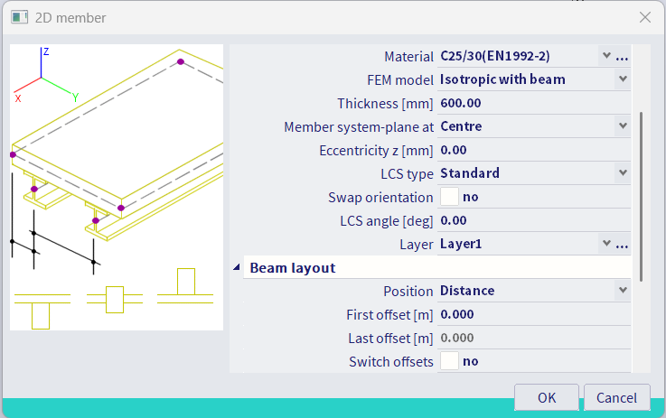

As a user want to also have scia models with ribbed slab so that the scia model is usable.

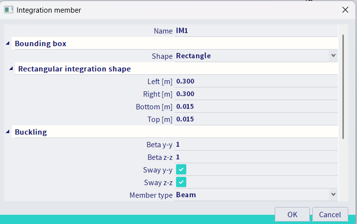

Using ribbed plates is common practice for a lot of structures. This is not possible yet with the external scia viktor sdk.
I think this is relevant for the VIKTOR platform because its i the only platform offering scia integration and this would further differentiate it in the market and enhance user adoption.
Currently only integration strips can be created, which do not integrate in 3D, Creating an integration meber will allow integration in 3D. In combination with adding eccentricity to the beams, you would be able to also have a ribbed plate.

@khameeteman do you know if this is possible?
@StijnJ I don’t know, never tried this component so we will have to test it
