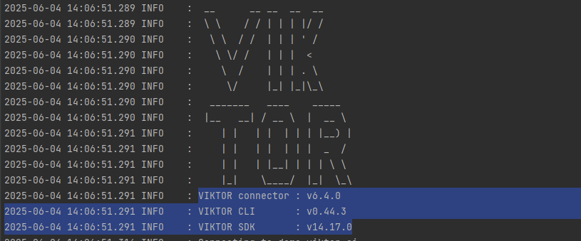

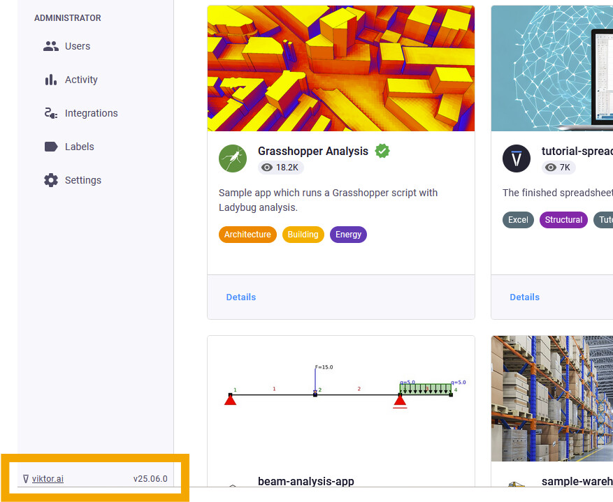

Could you share the following information with me?
Online: viktor.ai: v25.06.0
At viktor-cli start:
2025-06-04 15:21:22.299 INFO    : VIKTOR connector : v6.4.1
2025-06-04 15:21:22.299 INFO    : VIKTOR CLI       : v0.44.3
2025-06-04 15:21:22.299 INFO    : VIKTOR SDK       : v14.21.0
