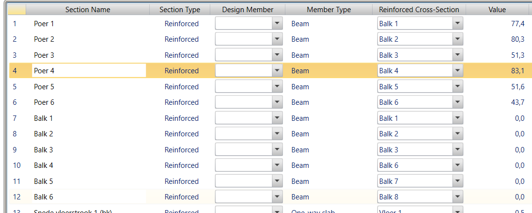

ProjectData seems to be working fine, naming of the DesignMember doesn’t really work:
<CheckMember>
<CheckMember xmlns:xsi="http://www.w3.org/2001/XMLSchema-instance" xsi:type="CheckMember1D">
<Id>1</Id>
<Name>name</Name>
</CheckMember>
<Id>2</Id>
<Name>name</Name>
</CheckMember>
<Id>3</Id>
<Name>name</Name>
</CheckMember>
<Id>4</Id>
<Name>name</Name>
</CheckMember>
<Id>5</Id>
<Name>name</Name>
</CheckMember>
</CheckMember>
It gets added to the xml, however it isn’t visible in Idea
We are using V22, maybe that is the reason?
I just checked and it only works in v23 indeed…
