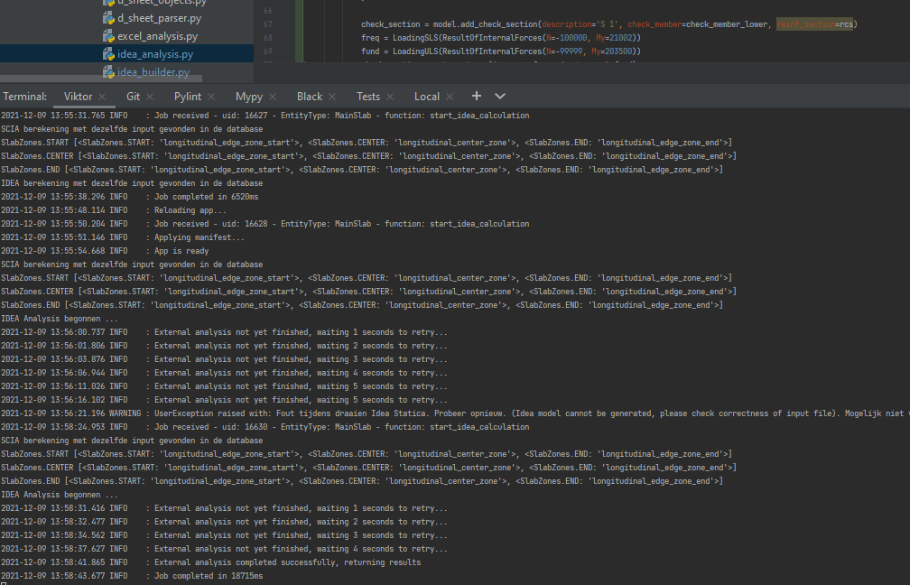

When using IDEA I get the following error.
However if I open the corresponding input.xml with the IDEA Rcs controller test application i get:
image"
Is there any information available regarding this error?
It used to work before as far as I know. But I can’t really find out where the bug is comming from.
Thanks in advance!

@rdejonge could it be that it depends on the size?
I have tried to build the model bit by bit and at some point (adding multiple check_sections) it sometimes works and sometimes returns the model cannot be generated)
The only thing I changed was My=200500 to My=203500 and it works…

I can imagine that there might be some limits regarding the amount of extremes that are added to the model. Was the model you are trying to evaluate very large?
it is a little bit large, however it used to work perfectely before:
                # for sls, uls, fat in itertools.zip_longest(sls_loads, uls_loads, fat_loads, fillvalue={"N": 0, "My": 0, "Vy": 0}):
                for i in range(2):
                    freq = LoadingSLS(ResultOfInternalForces(N=-100000, My=21002))
                    fund = LoadingULS(ResultOfInternalForces(N=-88888, My=203600))
                    check_section.create_extreme(frequent=freq, fundamental=fund)
If i use the bottom loop i in range 2, it works fine. If i do the same for a larger loop (commented line) it crashes.
