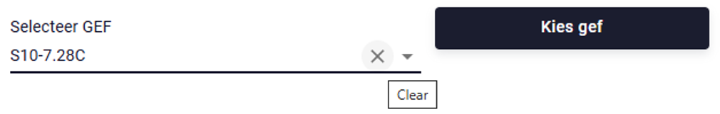

Give the OptionField an “x” button similar to AutoCompleteField.
Use AutoCompleteField instead of OptionField. Possible, but not always ideal.
