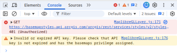

Do you see any additional errors in the developer tool console of the browser? For example, when I run this without a proper API key the javascript raises the following error:

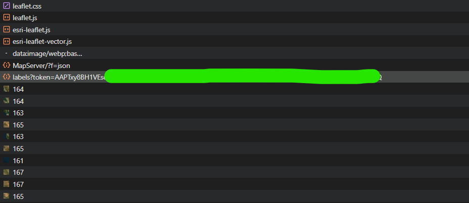

No. Even I inspected in Network, the api call for labels is returned with 200 response. But after the API call the view is not able to render or atleast not able to call pbf files. See screenshot

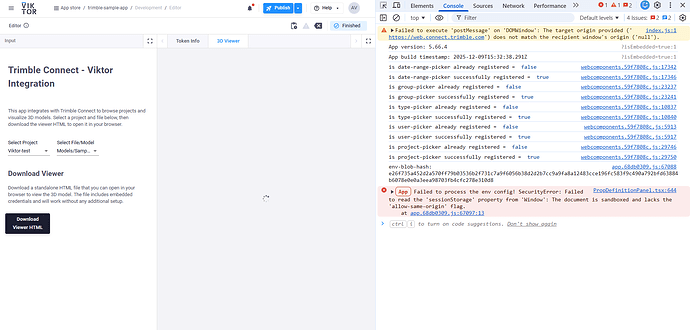

Something similar happened to me when I was building the Trimble Connect–VIKTOR integration. The viewer failed during startup with an error saying it couldn’t read ‘sessionStorage’. I think this is because VIKTOR loads the viewer inside a sandboxed iframe without ‘allow-same-origin’, so the iframe ends up with origin null and Web Storage is blocked.
What worked for me (kind of) was creating a download button to download the HTML, and when you click it, it opens in a new tab in the browser.
