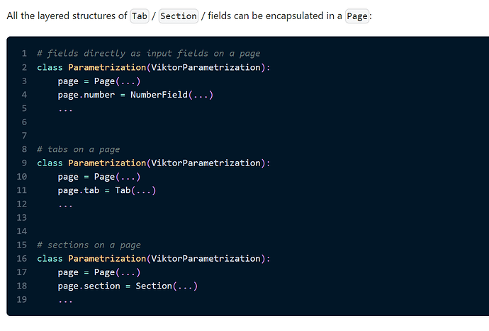

To add to @Daniel’s answer, and for future readers who get similar errors while playing with ‘Page’/‘Tab’/‘Section’, here is another possible source of error:
It seems that if a ‘Section’ exist within a ‘Page’, bare ‘Field’ params cannot be used under the same page but outside ‘Section’, either before or after. ‘Field’ and ‘Section’ cannot co-exist under an upper layer.
For example, the following doesn’t work:
class Parametrization(ViktorParametrization):
    page_1 = Page('Page 1')
    page_1.section = Section('section')
    page_1.section.input_1 = TextField('This is a text field')
    page_1.input_2 = NumberField('This is a number field')  # this line gives the error Invalid parametrization
This describes the allowable structure (source in the docs):
