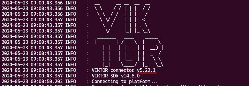

  • What VIKTOR version are you running?
  • What connector version are you running?
  • What CLI version are you using?
The first one is the VIKTOR version in your requirements.txt.
The second you can find when you start the app
And the third one when you run viktor-cli version
[UPDATE] I see now that you already metioned those in the first post.
We have recently updated the viktor-connector (v5.24.2) which fixes a deadlock issue on Windows. Could you try to re-install your app please? It will automatically install the latest connector and it should be resolved.
I have re-installed now and the StopJob has not yet appeared, even if I try my best to force it (by quickly altering fields in the parametrization).
