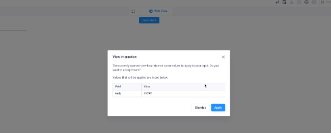

We want to use the JavaScript SDK in our webviews in order to make our own input fields for the app. However, we cannot use it right now, because the ‘View Interaction’ screen pops up. Is there a way to skip that and directly send the params to the parametrization of viktor without having to press ‘Apply’?

It is now possible to skip the confirmation modal, such that the parameters are immediately send to the parametrization. You can do this by adding an extra argument (skipConfirmation, which is false by default) to in the sendParams function:
    function sendName() {
      viktorSdk.sendParams({
        hello: "VIKTOR"
      }, true);
This has also been added to the docs.
