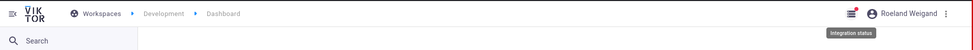

You can create (and read about) workers through this part of our documentation, and you can check if there are workers connected to your workspace by opening it and click the “integration status” button:

When you start your development workspace, does it show a green bubble indicating that a worker is connected? It sounds like maybe there is something going wrong with the administration of workers: in your admin panel you can link workers to workspaces (or set them to be global). Perhaps the old worker is still connected to the dev workspace? If you could indicate the current status of all workers connected to the app, perhaps that is a good place to start looking for a solution
