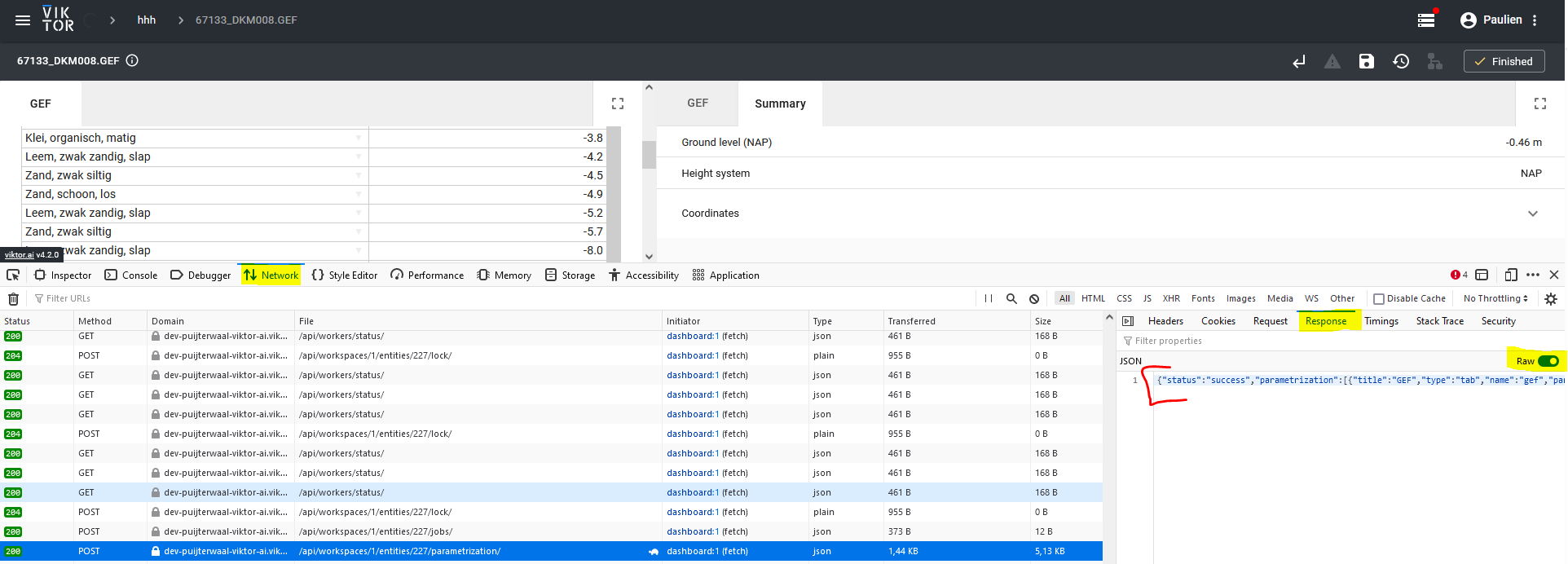

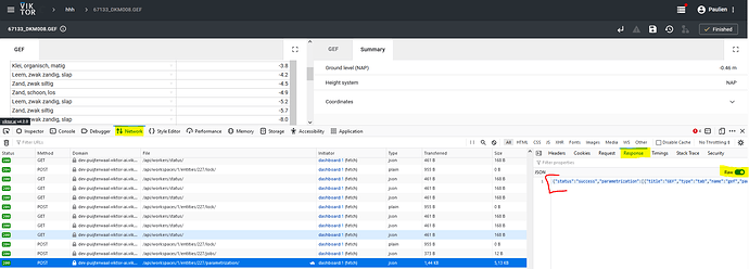

Thanks! That saves me quite some time in formatting :smile: In firefox, this can be accessed trough : right click > inspect > Network tab, Then change some value and wait for the parametrization to appear under File. Then in the right hand tab under Response, toggle on “Raw”, and you have the json ready to be copied!
Edit: Instead of Response under the tab Request, see @khameeteman’s reply

Please note that you currently are looking at the “parametrization” instead of the params. Params can be obtained in the Headers → Request payload (as in Marcel’s example).
