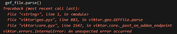

I’m trying to upload some gef files in a workspace but all gefs fail to upload. The error I’m presented with is as follows.
The code in which the error is raised is shown below (I reproduced the error in debug mode).
I have tried to play around with the arguments for the .parse() call but I have not been able to find a way to not get the error raised. Could anyone let me know what is wrong with the gef file(s)? Then I can try to edit the gefs manually so that they can be used in my workspace. Thanks!

Hello,
I suspect that the reason is that the GEF file contains a second ā€œ=ā€ on the line containing XYID and ZID. Specifically:
#XYID= 31000, 150643.30, 564205.30, 0.03, 0.03 = landcode, X-coordinaat, Y-coordinaat, meetonzekerheid X, meetonzekerheid Y
#ZID= 31000, -5.11, 0.03 = landcode, Z-coordinaat (waterbodem), meetonzekerheid Z
I did not test it yet (can give it a try tomorrow). I tested it out and it seems to work when you replace the above lines with:
You would need to do something similar for all of your gef files.
I hope this helps,
Jorn
Sorry for the late reply Jorn but thanks for figuring it out, I will make sure to change my GEFs to avoid the = symbol.
