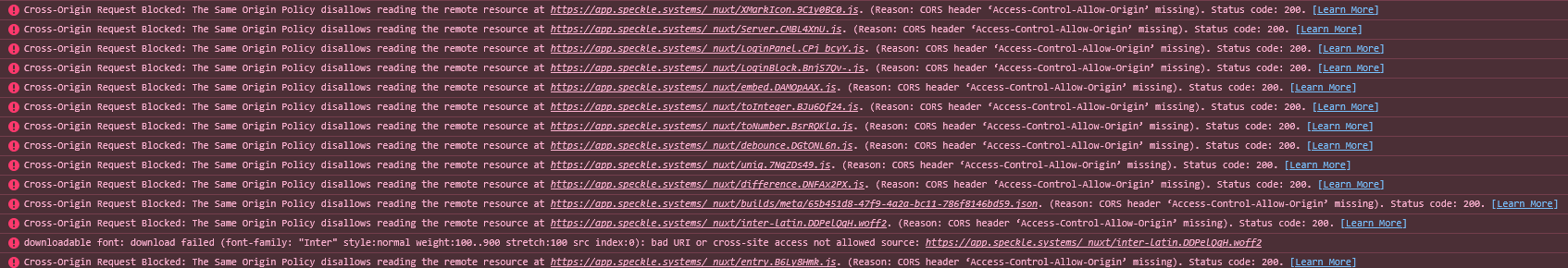

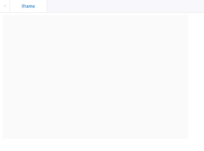

I’ve attempted to do this with an webview and the following html code:
This leads me to a blank embed box, and a bunch of CORS errors! Is it currently possible to embed iframes using the web view? If not, any suggestions for how I can embed a speckle model within the application?

The issue that you are experiencing is because the WebView which is basically an iframe that loads and renders your html, does not have the header allow-same-origin added, which is required by the Speckle.
To change this could be a security risk (I don’t have knowledge of this aspect, so I’ll leave it to others to elaborate on this aspect). It is also an issue that Speckle have raised themselves:
