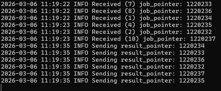

Six calculations with the TypeError:

It seems you have access to the server where the worker is, as you can show the logs. Can you then also see the jobs folder and check what happens when a job is triggered? Can you see the actual input file landing, and the output file being created? They are only shortlived but if you time it right you could copy it and inspect it.
These files are way too shortlived to be able to catch and copy. The input file is exactly the same, when I run it in D-Settlement myself I see the error log. But I cannot get the error file using DSettlementAnalysis().get_output_file(“.error.log”). I get a TypeError (which is not documented being possible to get), I again assume this is a bug, except if you tell me that you were able to get the error log from DSettlementAnalysis (or D-Foundations).
