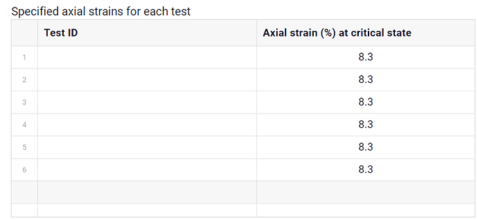

Hi mslootweg,
Many thanks, it worked! But when I want to pass a two column list to Table, it only allowed one.
In the case below, only Axial strain (%) was passed to the Table from number_list, while the number_list contains both Test ID and Axial strain (%), which is printed as Number List: [{‘Test ID’: ‘Test 10’, ‘Axial strain (%)’: 8.3}…

Hi @Hao ,
I suspect that it has to do with the keys that you are using for your number_list. Fields are defined as names without spacings, and from your example it looks like you might be using the labels. Your snippet does not include your parametrization, but I suspect that it should be changed to something like:
number_list.append({"test_id": file_stem, "axial_strain": 8.3})
with test_id and axial_strain referring to the parametrization attribute that you’ve defined the table’s columns.
Thans Mslootweg! It is indeed the spacing, which quickly solve the problem…
