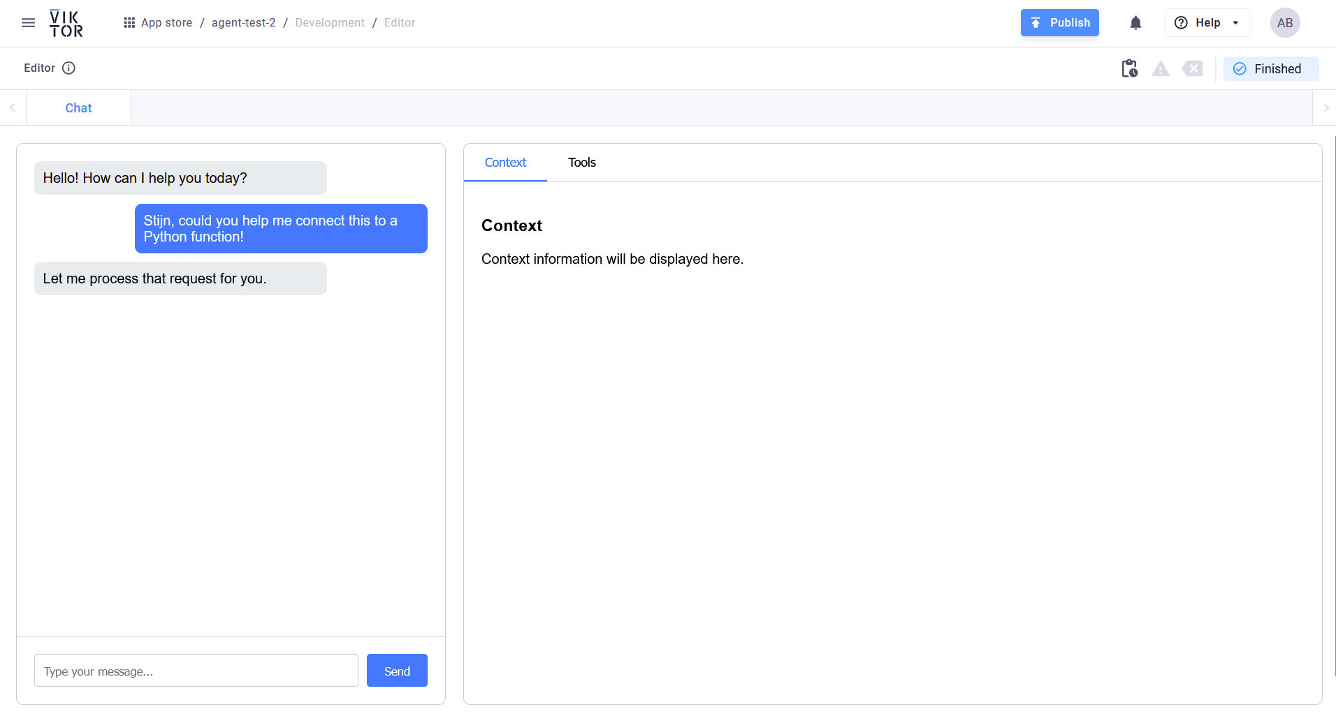

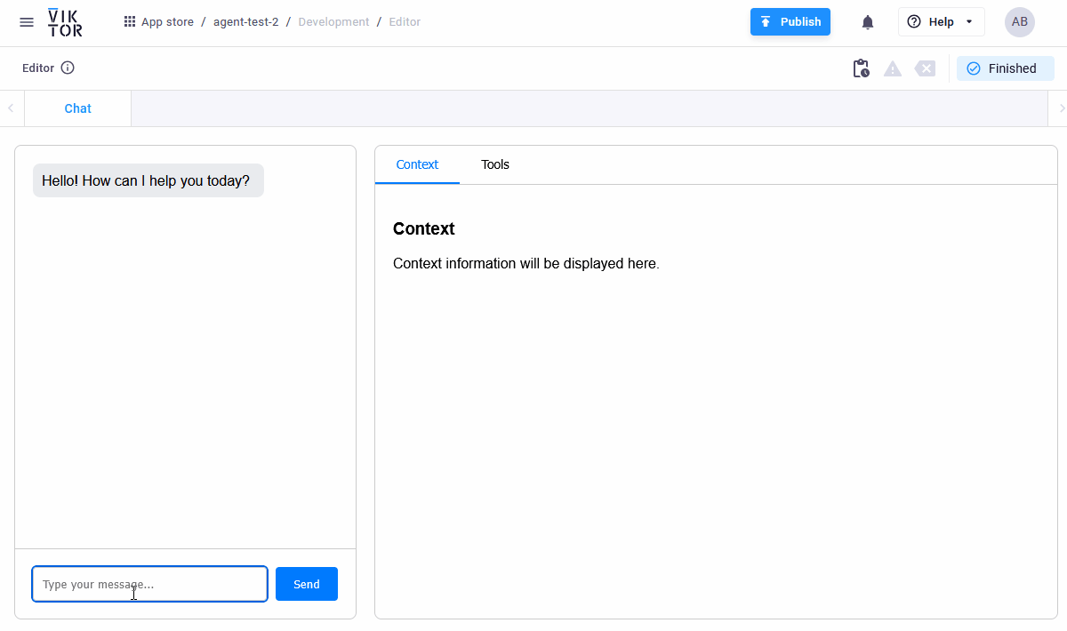

Hi Stijn,
So, this is an image of the interface. Now the chat just give a random answer from a list. But instead of that, I would like to get the agent’s answer from a function called: get_response()
The question is, how do I get this line to call get_response without loosing the conversation in the chat interface. A job will reload the webview.
const SAMPLE_RESPONSES = """ + str(SAMPLE_RESPONSES) + """ <==== Call get_response instead;
Here the complete code. I reduced it so much as I could:
