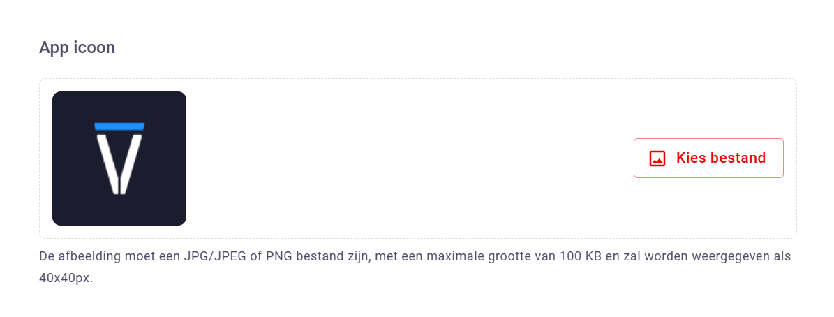

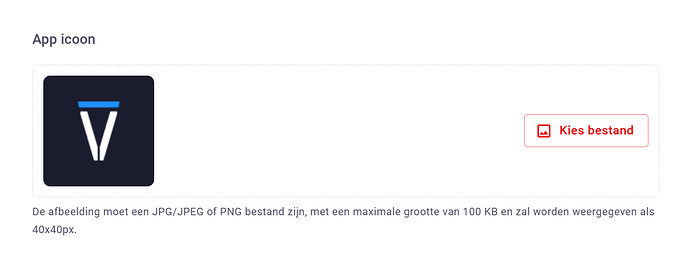

The icon is wat is set here (in edit app, Dutch language version):

The icon it seems IS in the app schema ( Get App | VIKTOR Documentation ), so I think you might be able to PATCH that as well, in much the same way. Let me know if you can get that working or if you need me to try it.

Ah yes that’s indeed a good catch, there are restrctions for both the image as well as the icon. You mention 1 MB, and if that works it works, I don’t know the restrictions by heart but if you go through the edit modal in the VIKTOR environment the mentioned restrictions are:
  • Image: The image can be a JPG/JPEG or PNG file with a maximum size of 600 KB.
  • Icon: The image must be a JPG/JPEG or PNG file with a maximum size of 100 KB and will be displayed as 40x40 pixels.
So that’s less than the 1 MB you mention!?
