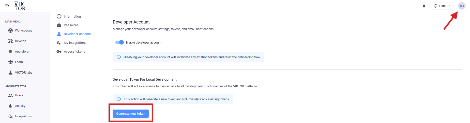

Hi @Jules,
running viktor-cli configure and going through the steps should do the trick.
If you don’t know your token anymore, you can easily generate a new token in your user settings:
Let me know if this works for you!

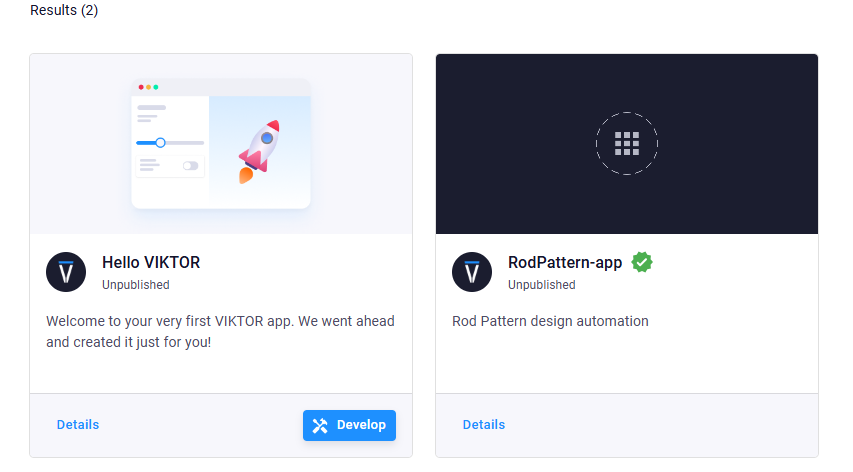

It doesn’t work, unfortunately. Even in my workspace, I cannot continue the app development
It seems that I’m not the maintainer any more, even though I’m on a free account and no-one as worked on this app.
EDITS :
So for some reason I was not the maintainer any more and after adding me again as the maintainer, it works perfectly fine.
