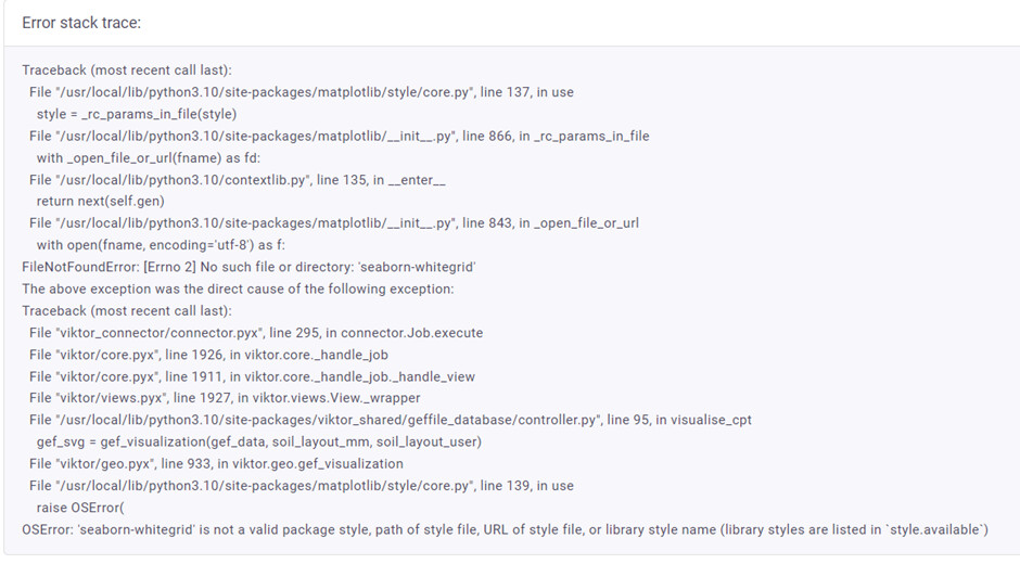

When releasing the exact code that I used in my development environment and trying to visualize a gef in the production environment I am presented with an error. The error is listed as follows.

I expect the gef_visualization to not throw an error but more generally speaking I expect the production environment to behave in the same way as my developer environment.

Thanks for reaching out, we are working on a fix in the SDK.
As a temporary fix you should be able to pin matplotlib in the requirements.txt like so:
matplotlib==3.7.0
This has been fixed in SDK v14.6.0! SDK v14.6.0 released 🎉
