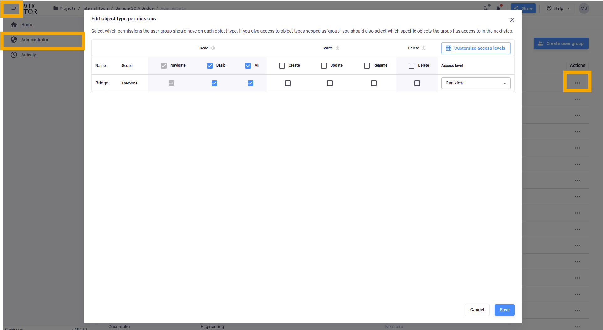

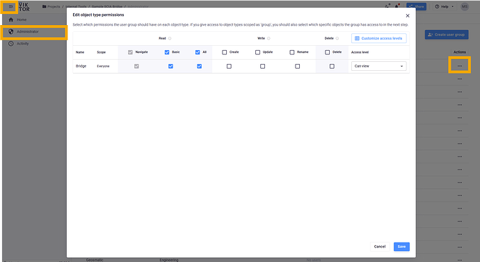

The options you are referring to are the environment’s access rights.
You can also set the workspace rights. Here is a link that gives an overview of the rights that you can set within a workspace:
To navigate to setting these rights, you enter your workspace, and click on the “Administrator” tab.
