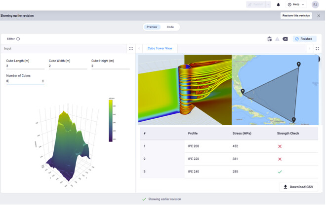

VIKTOR’s design currently assumes a panel on the left for input parameters and buttons (defined in the Parametrization class), and the right for views (defined in the Controller class). The new design should either consider making the existing panels adjustable/configurable, or to add panels within the existing design (from a definition perspective I prefer the latter).
Taking the latter case, an idea would be to have something like a ViewField, where the developer can embed a view on the left-hand side. The right could have something similar, with for example a MultiView decorator, where the user can then configure multiple views as columns and rows, similarly as to how plotting packages handle subplots.
This design solves a lot of the requests that are there related to get more views on one page, but does not yet resolve requests such as have input fields divided in sections that represent columns (multiple panels next to one another) on a page. I leave it up to the comments section for ideas.

And the result:
None
