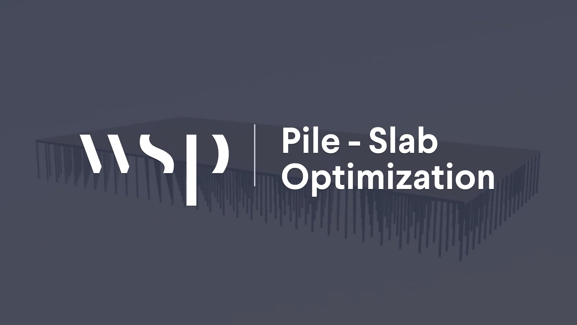

But to get back to what is currently possible: Here is a concept app built by WSP demonstrating how this looks like (in their case they built an app that connects other apps with one another):
